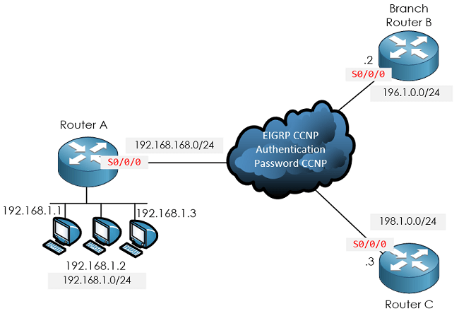

2. Refer to the exhibit. The services at branch B are down. An engineer notices that router A and router B are not exchanging any routes. Which configuration resolves the issue on router B?
RouterA#debug eigrp packets
(UPDATE, REQUEST, QUERY, REPLY, HELLO, UNKNOWN, PROBE, ACK, STUB, SIAQUERY, SIAREPLY)
EIGRP Packet debugging is on
RouterA#
*Jan 14 16:39:24.927: EIGRP: Gil: ignored packet from 192.168.168.2, opcode 5 (missing authentication)
*Jan 14 16:39:25.619: EIGRP: Sending HELLO on Gil
paklen 60
*Jan 14 16:39:25.619: AS 100, Flags 0x0: (NULL), Seq 0/0 interfaceQ 0/0 iidbo un/rely 0/0
RouterA#
A.
router eigrp 100
network 192.168.168.0
key chain EIGRP
key 1
key-string CCNP
interface serial 0/0/0
ip address 192.168.168.2 255.255.255.0
ip authentication key-chain eigrp 100 EIGRP
negotiation auto
B.
router eigrp 100
key chain CCNP
key 1
key-string EIGRP
interface serial0/0/0
ip authentication mode eigrp 100 md5
negotiation auto
C.
router eigrp 100
key chain EIGRP
key 1
key-string CCNP
negotiation auto
D.
router eigrp 100
key chain EIGRP
key 1
key-string CCNP
negotiation auto

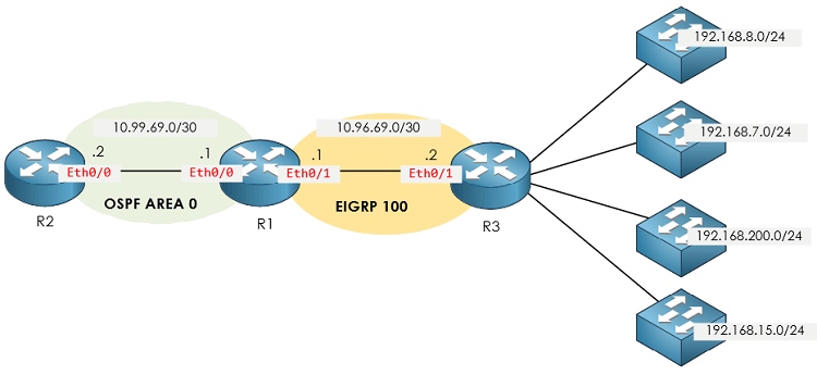

5. Refer to the exhibit. The engineer configured route redistribution in the network but soon received reports that R2 cannot access 192.168.7.0/24 and 192.168.15.0/24 subnets. Which configuration resolves the issue?
R1#show route-map
route-map FROM->EIGRP, permit, sequence 10
Match clauses:
ip address (access-lists): 10
Set clauses:
Policy routing matches: 0 packets, 0 bytes
R1#show run | sec router
router eigrp 100
network 10.96.69.0 0.0.0.3
no auto-summary
eigrp router-id 1.1.1.1
router ospf 100
router-id 1.1.1.1
log-adjacency-changes
redistribute eigrp 100 subnets route-map FROM->EIGRP network 10.99.69.0 0.0.0.3 area 0
R1#show ip access-list
Standard IP access list 10
10 permit 192.168.16.0, wildcard bits 0.0.3.255 11 permit 192.168.0.0, wildcard bits 0.0.7.255 20 deny any
A.
R1 (config)#ip access-list standard 10
R1 (config-std-nacl) #no 10 permit
R1 (config-std-nacl) #no 11 permit
R1 (config-std-nacl) #10 permit 192.168.0.0 0.0.3.255
R1 (config-std-nacl) #11 permit 192.168.8.0 0.0.3.255
B.
R1 (config) #ip access-list standard 10
R1 (config-std-nacl) #10 permit 192.168.4.0 0.0.3.255
R1 (config-std-nacl) #11 permit 192.168.12.0 0.0.3.255
C.
R1 (config-std-nacl) #11 permit 192.168.8.0 0.0.7.255
D.
R1 (config-std-nacl) #10 permit 192.168.0.0 0.0.7.255
