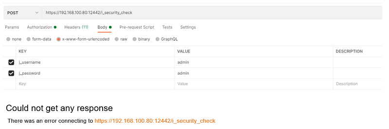

7. Refer to the exhibit. What step resolves the authentication issue?
Type       PROT  SYSTEM IP   ID        ID          PRIVATE IP                              PORT
PUBLIC IP                             PORT         LOCAL COLOR      PROXY STATE UPTIME      ID
vsmart dtls 0.0.0.0          100       1           192.168.100.80
12346 10.10.20.70                                    12446 default         No   up
0:02:24:09      0
vbond  dtls 0.0.0.0            0       0           192.168.100.81
12346 10.10.20.80                                    12346 default         -   up
0:02:24:10      0
vmanage  dtls 4.4.4.90       100       0           192.168.100.82
12346 10.10.20.90                                    12446 default
A. Restart the vsmart host
B. Target 192.168.100.82 in the URI
C. Change the port to 12446
D. Use basic authentication

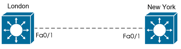

10. Refer to the exhibit. Communication between London and New York is down. Which command set must be applied to resolve this issue?
London(config)#interface fa0/1
London(config-if)#switchport trunk encapsulation dot1q
London(config-if)#switchport mode trunk
%LINEPROTO-5-UPDOWN: Line protocol on Interface FastEthernet0/1, changed state to down
%LINEPROTO-5-UPDOWN: Line protocol on Interface FastEthernet0/1, changed state to up
London(config-if)#end
NewYork#show dtp interface fa0/1
DTP information for FastEthernet0/1:
    TOS/TAS/TNS:                 ACCESS/AUTO/ACCESS
    TOT/TAT/TNT:                  NATIVE/ISL/NATIVE
A.
NewYork(config)#int f0/1
NewYork(config)#switchport nonegotiate
NewYork(config)#end
NewYork#
B.
NewYork(config)#switchport trunk encap dot1q
NewYork(config)#end
NewYork#
