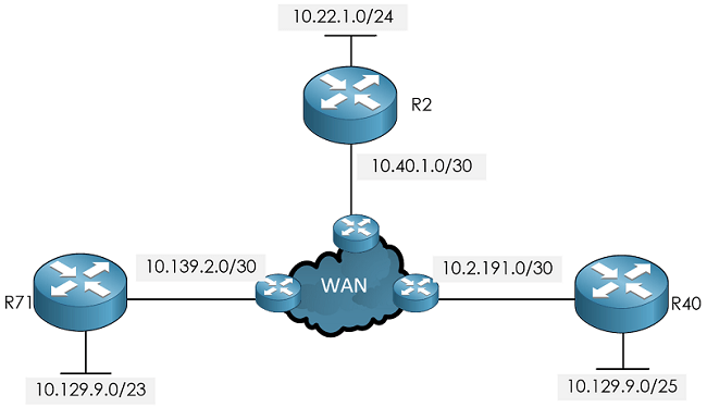

1. Refer to the exhibit. All routers in the network are configured correctly, and the expected routes are being exchanged among the routers. Which set of routes are learned from neighbors and installed on router 2?
A.
10.129.9.0/23
10.139.2.0/30
10.2.191.0/30
10.129.9.0/25
B.
10.129.9.0/23
10.40.1.0/30
10.2.191.0/30
10.129.9.0/25
C.
10.40.1.0/30
10.139.2.0/30
10.2.191.0/30
10.129.9.0/25
D.
10.129.9.0/23
10.139.2.0/30
10.129.9.0/25
10.22.1.0/24

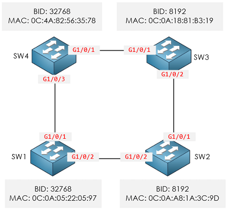

2. Refer to the exhibit. Which switch in this configuration will be elected as the root bridge?
A. SW1
B. SW2
C. SW3
D. SW4

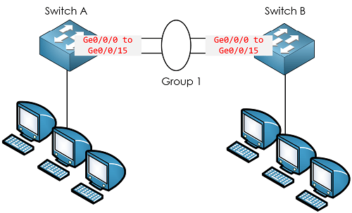

6. Refer to the exhibit. The LACP EtherChannel is configured, and the last change is to modify the interfaces on SwitchA to respond to packets received, but not to initiate negotiation. The interface range gigabitethernet0/0/0-15 command is entered. What must be configured next?
A. SwitchA(config-if-range)#channel-group 1 mode auto
B. SwitchA(config-if-range)#channel-group 1 mode active
C. SwitchA(config-if-range)#channel-group 1 mode desirable
D. SwitchA(config-if-range)#channel-group 1 mode passive
