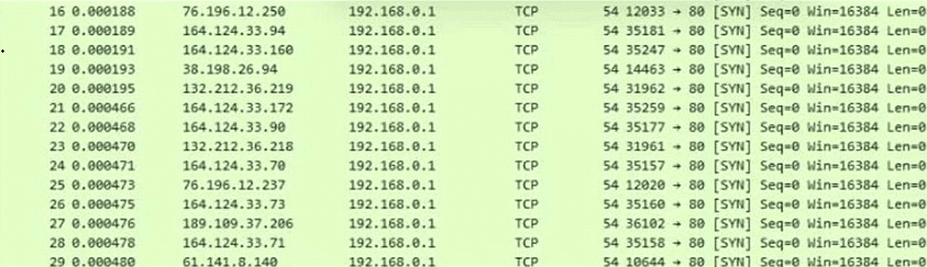

1. Refer to the exhibit. What is occurring?
A. ARP spoofing attack
B. man-in-the-middle attack
C. brute-force attack
D. denial-of-service attack
